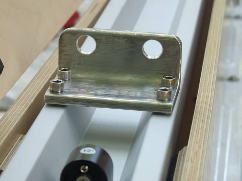

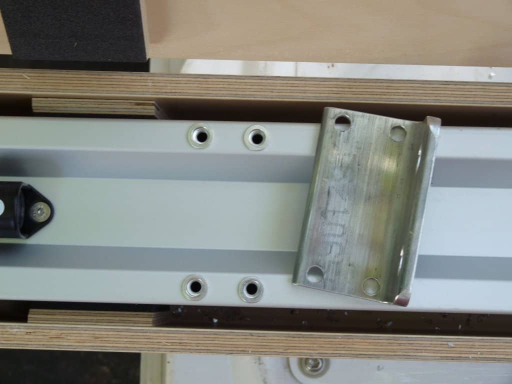

I took a different approach, using RivNuts to attach a simple angle bracket. No welding required.
Posted : June 19, 2015 11:26 am
