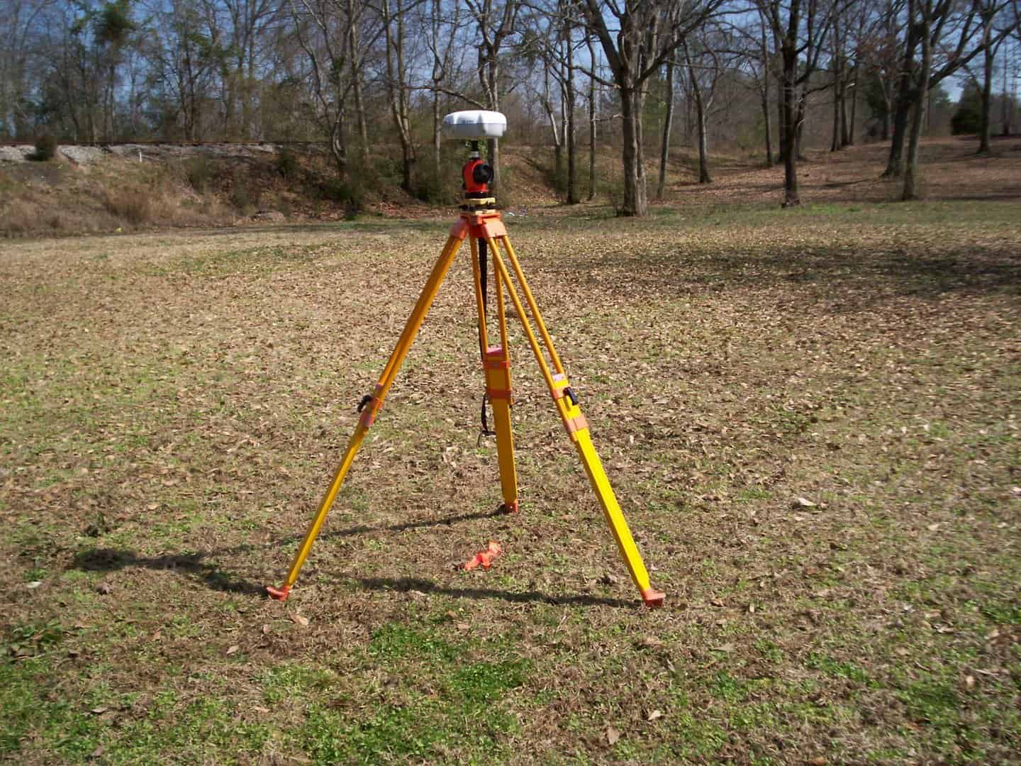

I've used a similar prism to the one shown above for running static sessions while running my robot to save time in the field. Here is a picture of one of my static setups. I have used this type of setup dozens of times with great success, and lots of time saved.

I use the same retro prism style under the antenna.
Being larger than normal, it is easy to see and shoot at most any distance.
If you have several, they can be stacked atop each other and point in the different directions you may BS from.

I've got a picture somewhere of a setup when we had two prisms stacked just as you describe, with the OPUSX90 on top of that. Chris Billingsley and I had two robots going on a large topo in D'iberville, MS several years ago. Worked like a champ.
