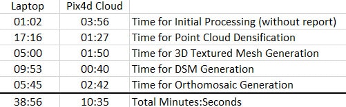

Comparison of processing time for the above small test project.
å±5.8ac at å±280' AGL with 40 photos.
39 minutes on my Laptop
CPU: Intel(R) Core(TM) i7-6700K CPU @ 4.00GHz (4 cores)
RAM: 32GB
GPU: NVIDIA GeForce GTX 980M (Driver: 21.21.13.6909)
OS: Windows 10
Pix4Dmapper Pro v3.01.18
10.5 minutes on Pix4d's Cloud PC
CPU: Intel(R) Xeon(R) CPU E5-2666 v3 @ 2.90GHz (10 cores)
RAM: 59GB
GPU: Cirrus Logic GD 5446 (Driver: unknown)
OS: Linux 3.13.0-91-generic x86_64

What about upload/download times to Pix4D's Cloud Server? How big are all the different files for this project that were uploaded and downloaded?

Using the same very small sample project.
0.35 GB UPLOAD for 40 photos
2.99 GB DOWNLOAD for Mesh, Point Cloud, DSM, Contours (DXF) and Orthomosaic
On average my projects have about 400 photos

Thanks. So for your average 400 photo project ~3.5 GB upload and ~30 GB download? That's about a 25 min upload and 45 min download at my office. That works for me.

Not quite linear on the DOWNLOAD, it was only 10Gb
