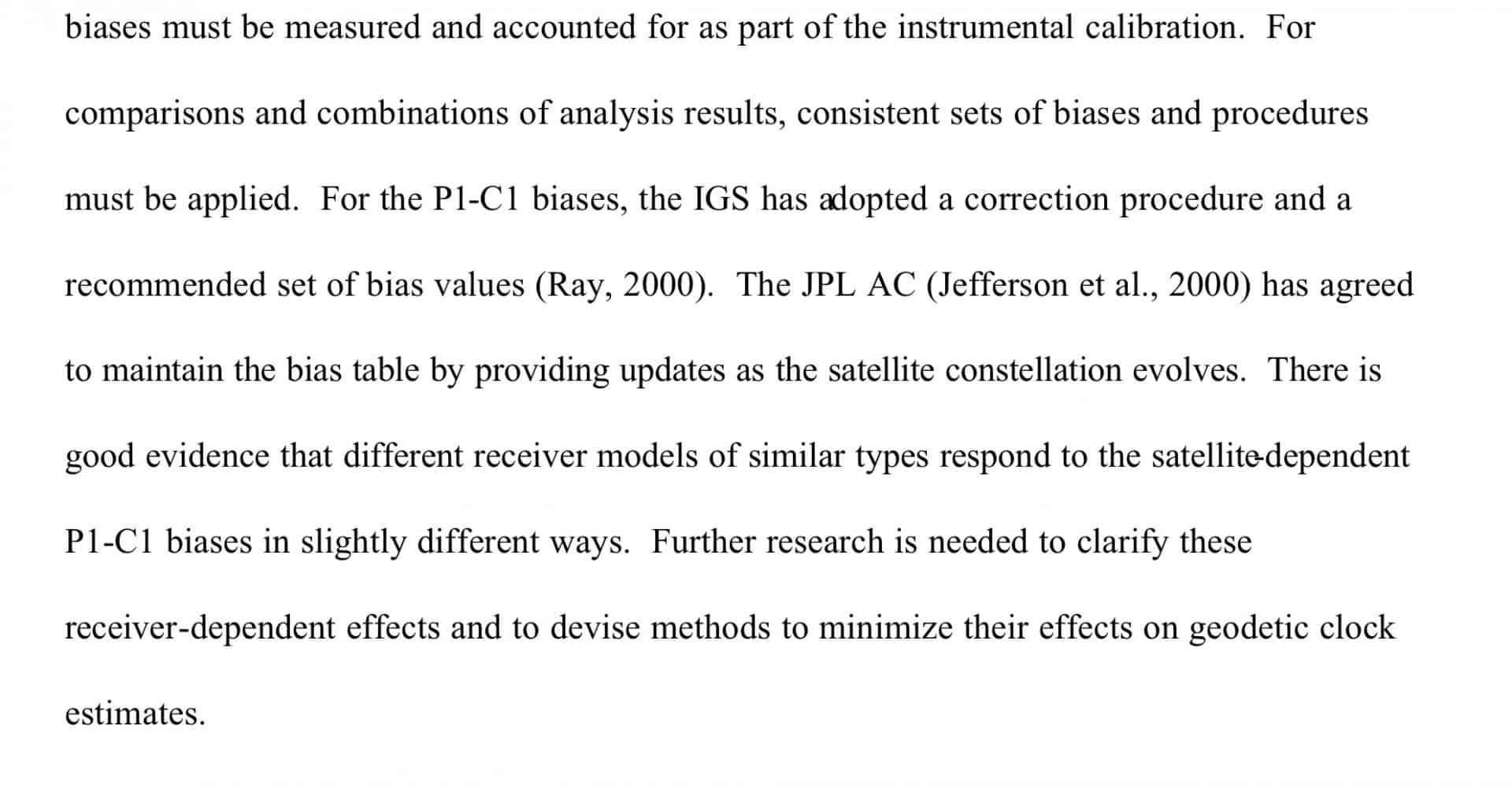

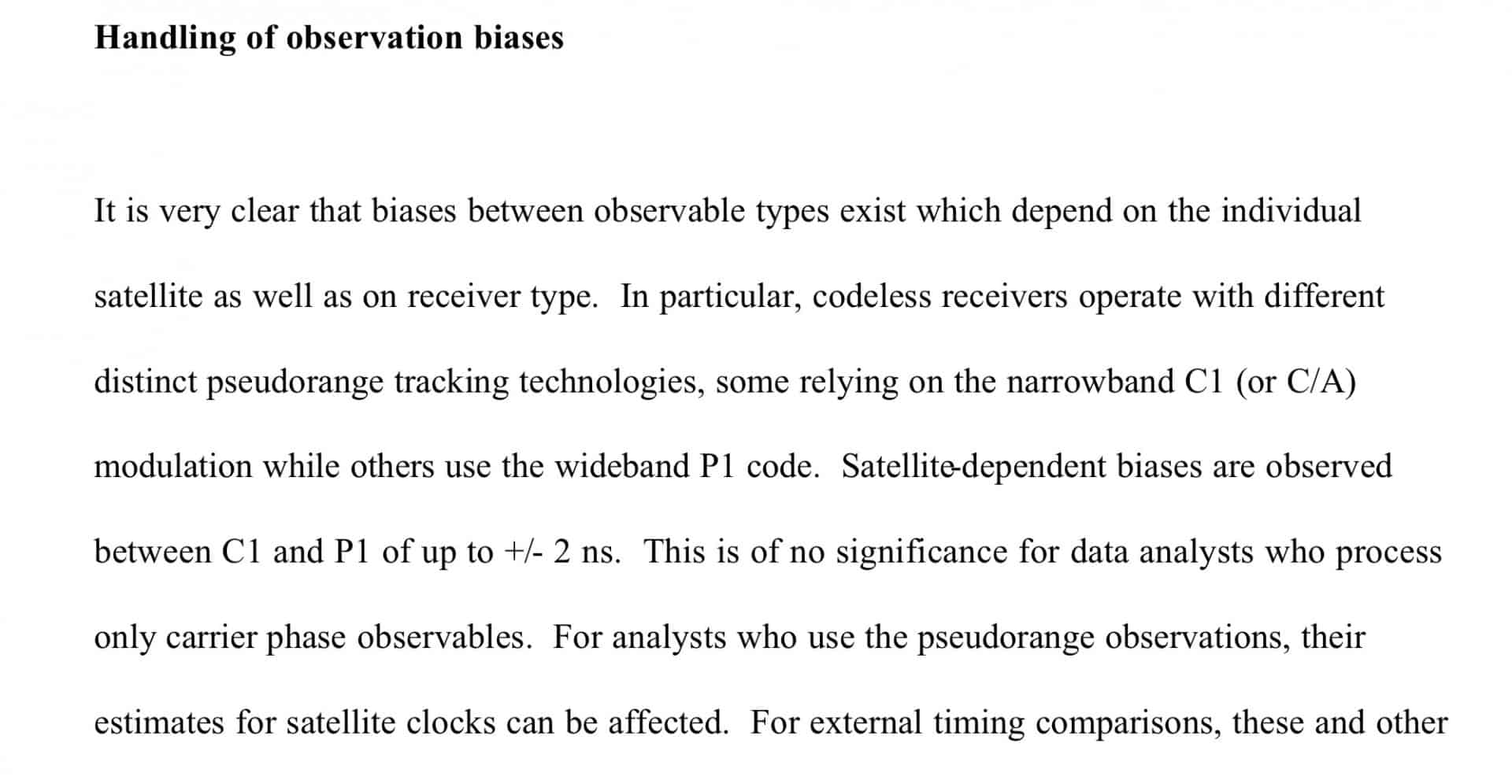

I was not trying to be unhelpful. The issue of cc v noncc is of interest to specialist users. I do not expect there to be much available in that "middle ground" level of detail.
I provide the following extracts from this site http://www.dtic.mil/get-tr-doc/pdf?AD=ADA390474 that reveal the "insignificance" of the issue to most persons processing GPS data.

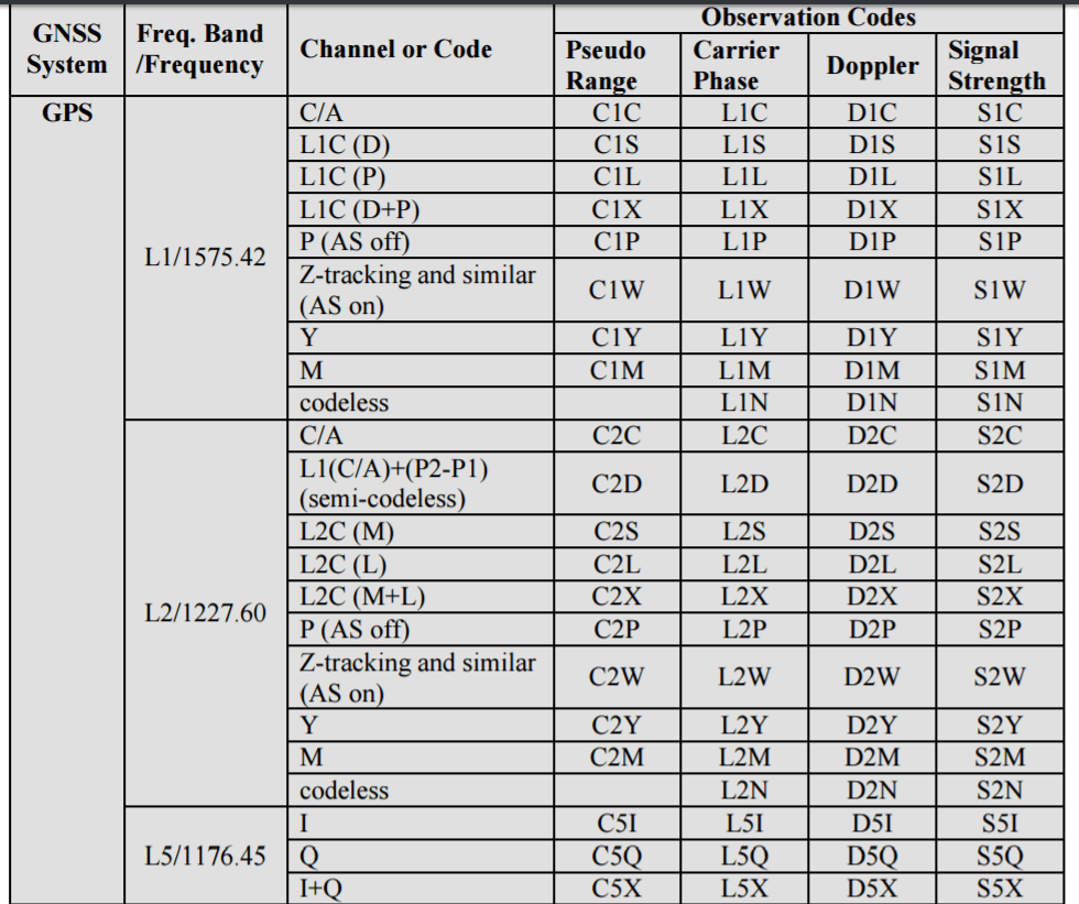

If Opus supported rinex version 3, it'd be possible to force the correct interpretation of the tracking mode, as that version offers separable observable codes, e.g., L2W for modern civilian receivers, L2D for the old Trimbles, etc.:
Table 4 in the Rinex 3 spec:
http://ftp://igs.org/pub/data/format/rinex303.pdf&apos ;">ftp://igs.org/pub/data/format/rinex303.pdf
