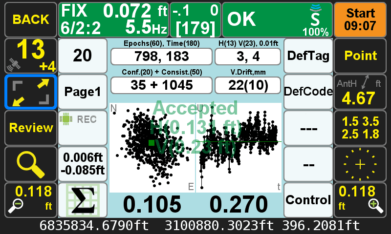

For now I cannot answer the question about RMS for the outlier points, but I can offer some data on the RTK points that were on the fringes of the average. The following screen captures were taken automatically by the software as specific points during collection. They are included in the final pdf report exported by the receiver.

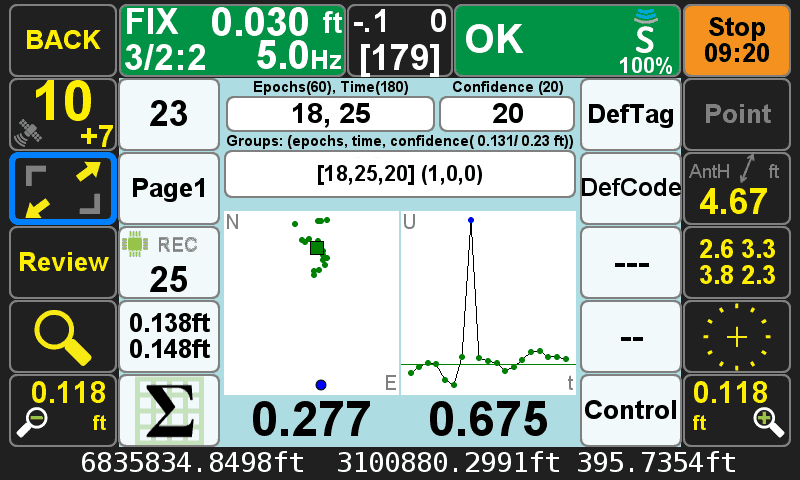

This shows our "Phase 1" verification phase where engines are constantly reset until a consensus can be made around a particular fix. The number or agreeable fixes that determines the consensus is set by the user under "Confidence Level". You see that one bad fix was identified in this phase. It exceeds my tolerance in horizontal and vertical distance from the consensus. This is 25 seconds after the shot started. In that time 20 different fixes were determined by the six RTK engines. The bad fix is rejected from the average position for the point.

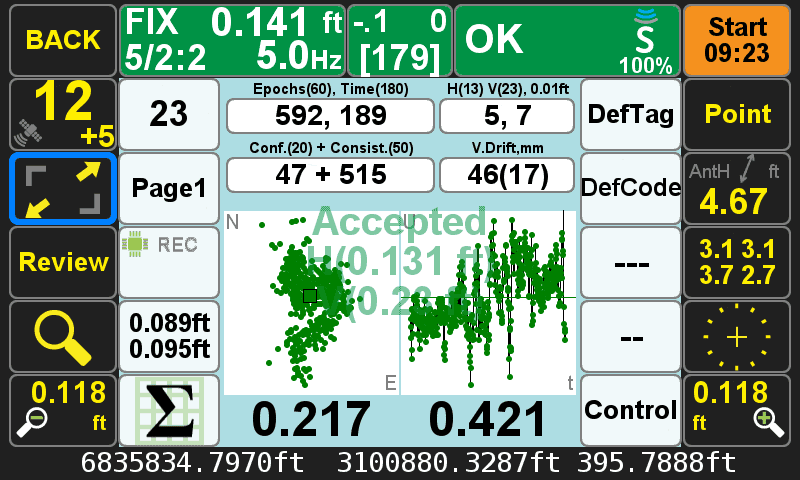

This is at the end of the shot, 189 seconds after the shot has begun. The screen plot shows a lot of noise, both in horizontal and vertical. This point was the worst of the 187 points collected, being almost 0.18' from the total station derived horizontal coordinates for this point and 0.34 foot from the elevation. The VRMS shows to be 0.07 foot (upper right white box) and the HRMS shows to be 0.05 foot. The 95% for the horizontal is 1.6x HRMS and the 95% for vertical is 2x VRMS, so these would be approximately 0.10 and 0.13 at 2 sigma. The plots seem more revealing though. Any points that exceed my tolerance of 0.13' horizontal from the average or 0.26' from the vertical are excluded from the average. If more than 30% of the total number or epochs are excluded, the software starts over automatically at "Phase 1". There is an option to show how many have been rejected, but I do not have it on in this screen capture.

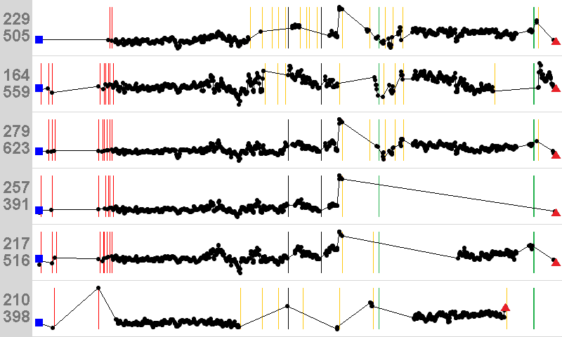

This shows the contribution of each of the six engines for the first phase. Notice that 2, 3, 4 and 5 contributed most of the fixes but each engine did contribute at least one fix. Since each engine relies on slightly different algorithms, this tells us that we have agreement between fixes using several different processing estimates.
This is the horizontal and vertical plot for the same period.
This is the vertical contribution for each engine for the entire 189 second observation

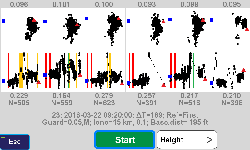

This is the combined vertical and horizontal contribution of each engine for the entire 189 second observation.
For the most part, I seldom check these graphs, but they are stored with every single observation (per user configuration) and available at any time for the user to review.
Were I standing at the instrument watching this shot, I would reject and start again. But I wasn't really doing a precision test, I was looking for failures. The extreme spread is more than I would expect, so I would have started again.

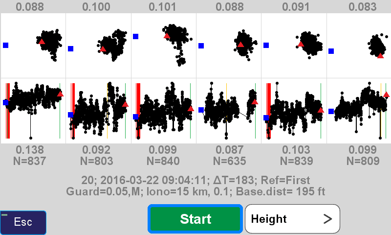

This is a comparison screen capture from a point recorded just prior to point 23. Point 20 is right at the edge of distance from the average that contains 68% of the 187 points. It's the outside of the 1 sigma ring, so to say, of the 187 points. It is 0.05' horizontal and 0.08' vertical from total station determined coordinates for this point. See if you can spot the difference from the much less accurate point 23...

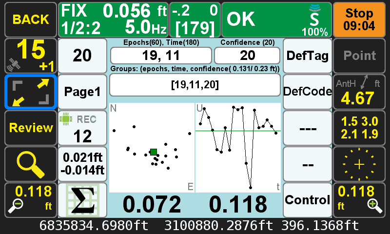

Here is the first Phase, where the software is constantly resetting the engines. The extreme spread of the individual fixes is relatively low.
Looking at the final position, the dot plot looks very uniform, no funny shapes (such as C's or hockey sticks). The closer that the horizontal plot looks like a thumb print, the better. And the closer that the vertical plot looks like a sine wave, the better. The extreme spread of the vertical is a little rough, but if you look carefully, the main reason for this is the early single engine epochs from Phase 1. The Horizontal RMS is 0.03' and Vertical RMS is 0.04'. This is noisier than we would expect in the open, but understandable given the canopy.

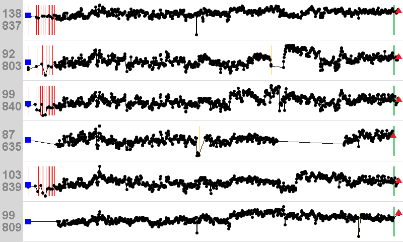

But ultimately all 6 engines were fixed at some point during collection. Notice engine three has a little trailing, but the others look very condensed.
