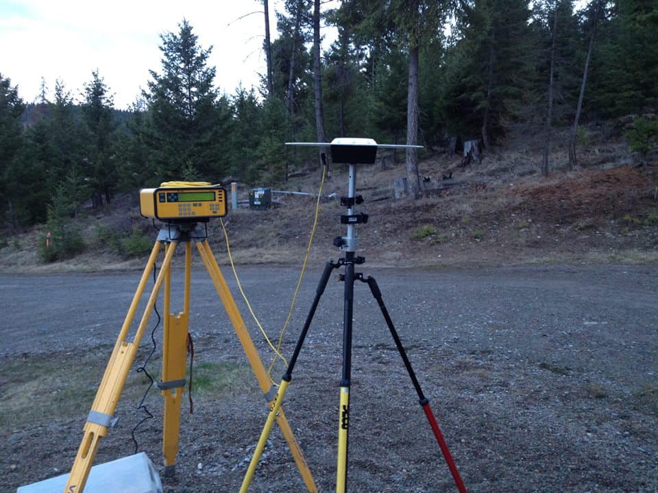

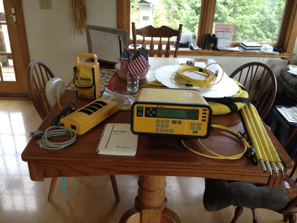

I bought this thru public surplus this spring from Washington state, had some plans to maybe monkey around with it on a project but some things have changed up here so I don't have extra time/inclination for that. Anyway- there were 3 units for sale and I got one of them- I'm pretty sure
one of the others is right here.
http://www.ebay.com/itm/Trimble-4000SST-GPS-Receiver-Geodetic-Antenna-Battery-and-Charger-/131479386177?pt=LH_DefaultDomain_0&hash=item1e9cc83841
I'll take $400 for the set-up your see in the table top picture. That Includes shipping in the lower 48 states and a $25 donation to surveyor connect.
the 2nd and 3rd pics are from an OPUS session I ran out my front door.
