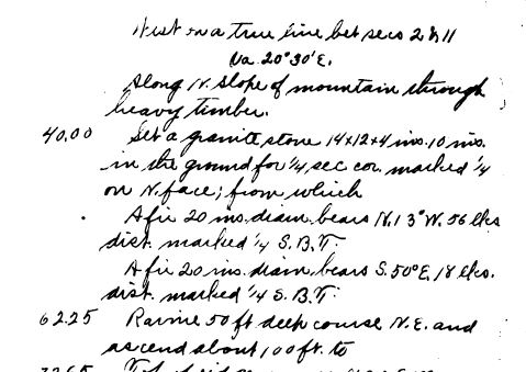

Walked in to my calc'ed position- No CCR on file - No surveys of record. Property to south is USFS. Prop north is Church camp- the prop in question is gov't lots on the North side of the Clark fork.
Here is the GLO-

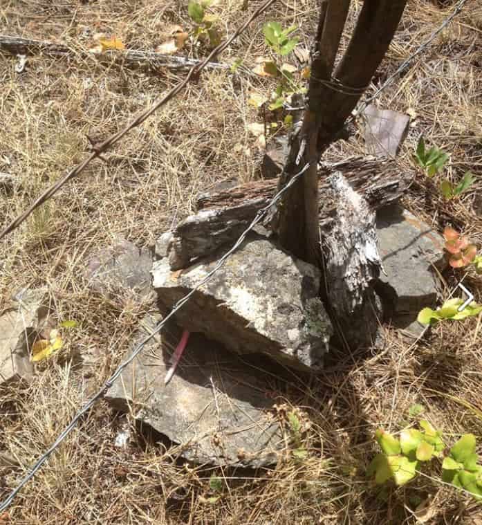

Anyway my stake out location puts me within 5 feet of this pile of stone in the fx line.

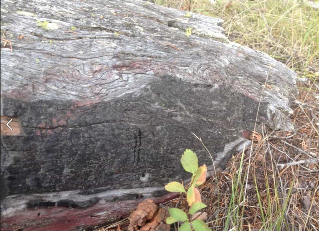

I looked around for the BT's.- found this stump for the BT to the NW. bearing distance are near the stone mound.

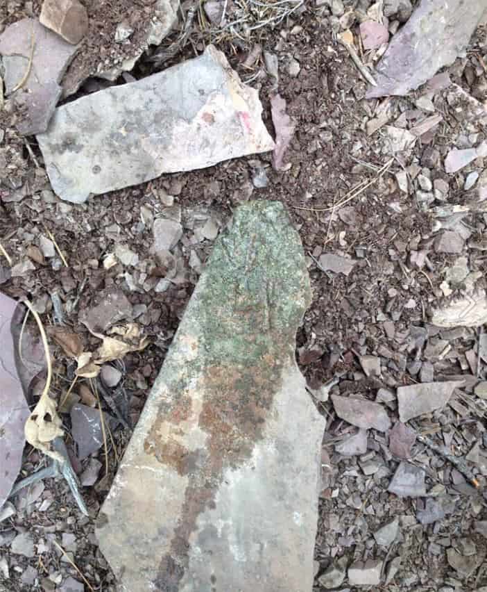

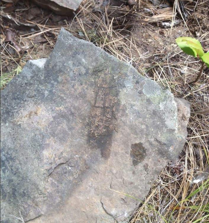

- I dismantled the rock pile and found this-
14"x11"x4"- it's the one that had the piece of ribbon under- (around) it in the top picture.
I hadn't taken any water on my little hike up the hill and had a bit of a tough time working up enough spit to clean the markings.

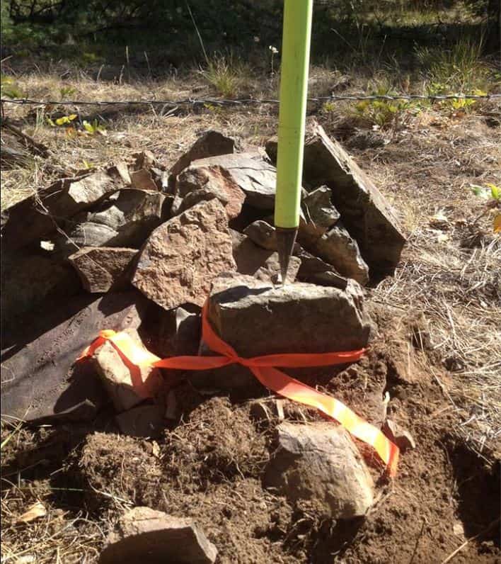

I probed around to the south for the other BT and found some wood fragments and a soft spot about at GLO record bearing and distance.
Distance -distance intersect was a bit oof of the mound and on undisturbed ground- 2- 3 feet away from the rock pile. I scraped around a bit and found a socket/depression that I believe to be the location where the stone had been originally.
I cleaned it out a bit and re-set the stone with the "1/4" on the North side and raised a nice mound of stone to the south. I scribed a big "+" on top of the stone and did my double ties WITH RTK (Kent Bait). Put a BT tag on the old stump.

I see a bit of pink flagging sticking out from under the rocks in the first picture.....[sarcasm]It has to be the corner right?[/sarcasm]
