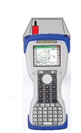

good idea....I was kind of hoping they made a cover for the top where all the ports are that would enclose the parani. Even an aftermarket one would do. I remember seeing plastic covers that went on top on some of the old trimble and leica collectors. (by old I mean like 5 years ago maybe.)
Posted : September 15, 2015 5:30 am
Dan Patterson
(@dan-patterson)
Posts: 1272
I was picturing something like this:
Only it would be kinda like this:

It could be printed like I did for the TSC2, although I would suggest a transverse mounting to save printing costs and space. Then use Jim's ribbon cable idea to make it compact

How much would it be to print something like that?

This is the link for the TSC2 version, which would be about the same size +/- http://shpws.me/JTmK I had to weather seal the TSC2 hat and you don't seem to have the same issue, so, in theory yours would be smaller
