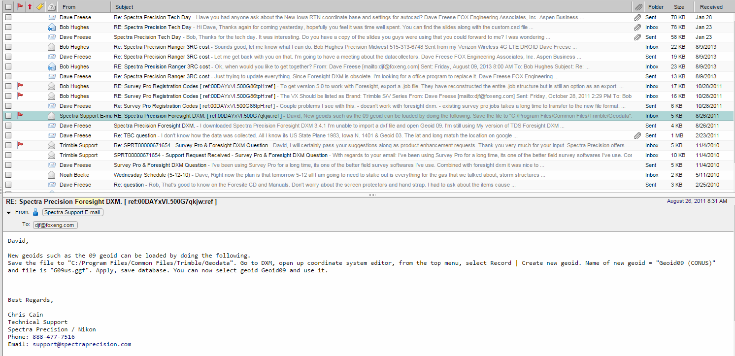

Hope the attached picture helps. I think I had to reboot my computer after I made the changes.

Thank you. I don't know that I ever rebooted my laptop after creating or updating the file. I will try that.

Thanks to Marvin Davis and Foxsurvey for their help. I can now open files without the error message.
