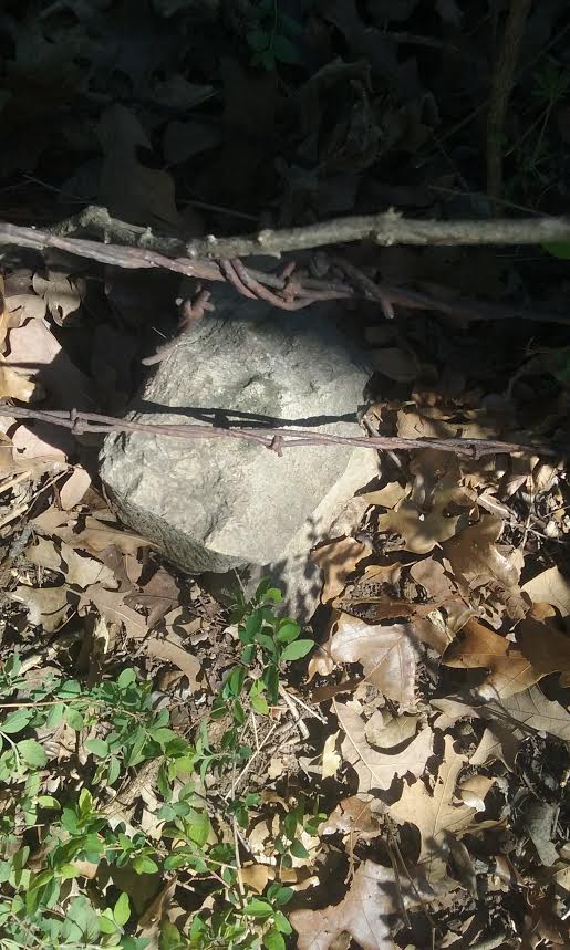

How large and solid is that stone?
It would be poor if it got moved, or shifted, creating a "virtual pincushion".
If it were possible, I'd set a tripod over it, Move the stone, drive some sort of monument, and replace the stone.
The idea being to prevent needless conflict.

Jacob Ellis, post: 368955, member: 11603 wrote: Nate thanks your comment made me think...Ok it's not the size of the file so pay attention (speaking to myself) max height 1920pix
max width 1080pix.......crop the photo! Which is probably the "shrink" Moe was referring too...I thought Moe ment file size. Non the less here is the picture even though the thread was awesome without it!!:good:
Jacob don't "crop" the drawing. You could go into "Paint" or some other picture editor, but in "Paint" do a "resize/skew" under "image". and resize it horizontally by x% and Vertically by the same %. It will make the drawing that much smaller but still show all the features without cropping the outside.

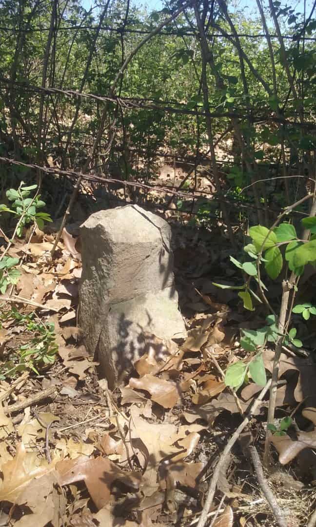

Thank you to everyone who commented on this thread. It turned out to be quite interesting (as I imagined) And here of a pic of a stone you'd have to be a fool to call out!!

Holy Cow I also try to remember and (in a way) pays my respects to those to set out to survey this great country
This is why i sometimes feel so fortunate!! That is one nicely set and very beautiful stone my friends!!
