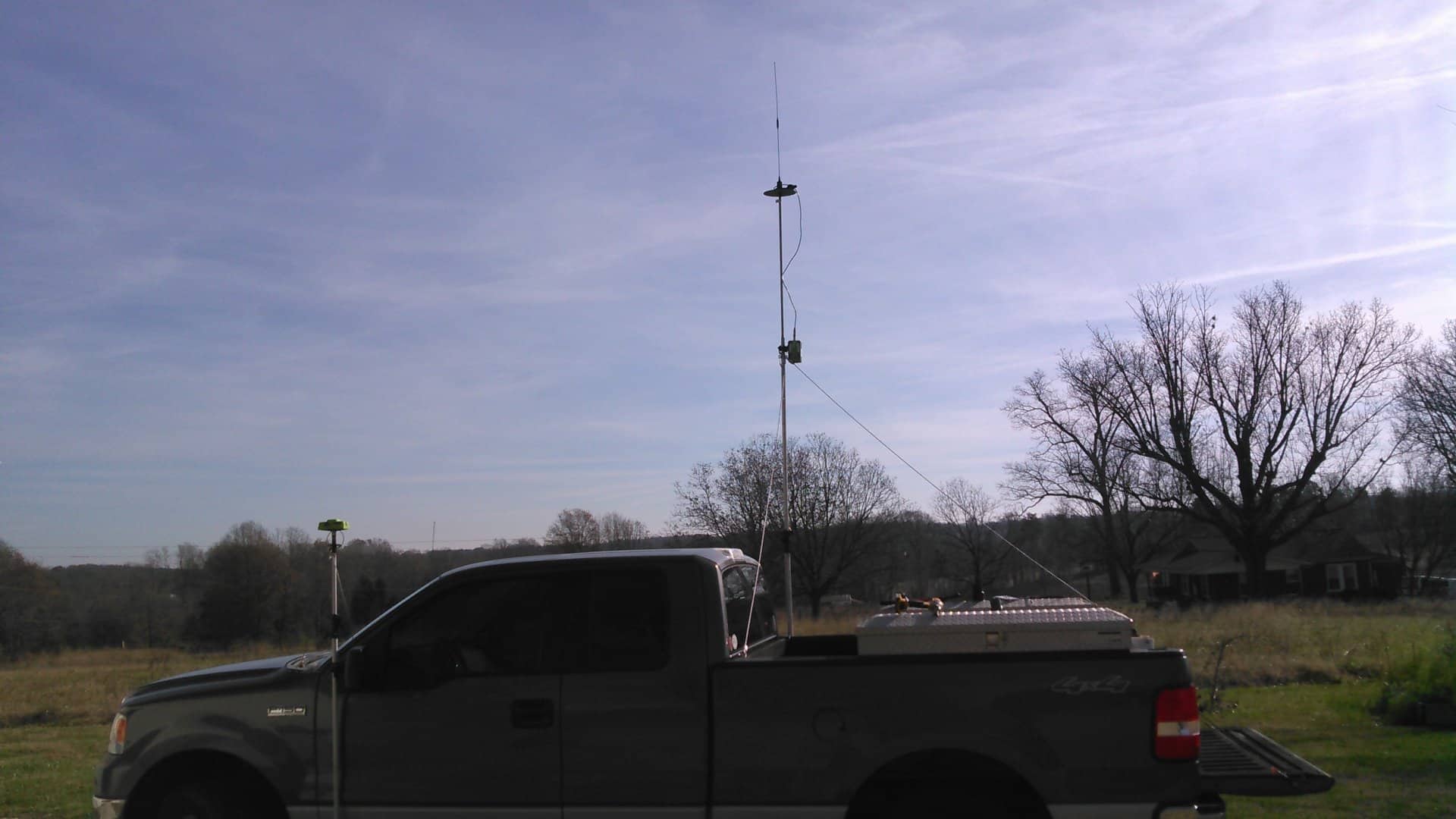

dmyhill, post: 350039, member: 1137 wrote: http://javad.com/jgnss/javad/news/pr20151113.html
Comments anyone? Has anyone done this?
Heres a pick of my setup.
Posted : January 24, 2016 10:12 am

Hmmm, thanks for the ideas.
With this new shift base, I think that could be useful.
Posted : January 24, 2016 1:26 pm

I have a great network to get on in NC. I set a point using the network, then shift to it. DPOS it too for a check. Sometimes I mount a prism under the base.
Posted : January 24, 2016 1:59 pm

Adam, post: 354688, member: 8900 wrote: Heres a pick of my setup.
What do you do with that? What sort of movement do you get at the top there (in wind especially)?
Posted : January 25, 2016 11:02 am
What do you do with this? (What sort of work?)
Assuming that you have done some sort of study, what sort of movement do you get at the top there? (Wind, getting into and out of the truck, etc.)
