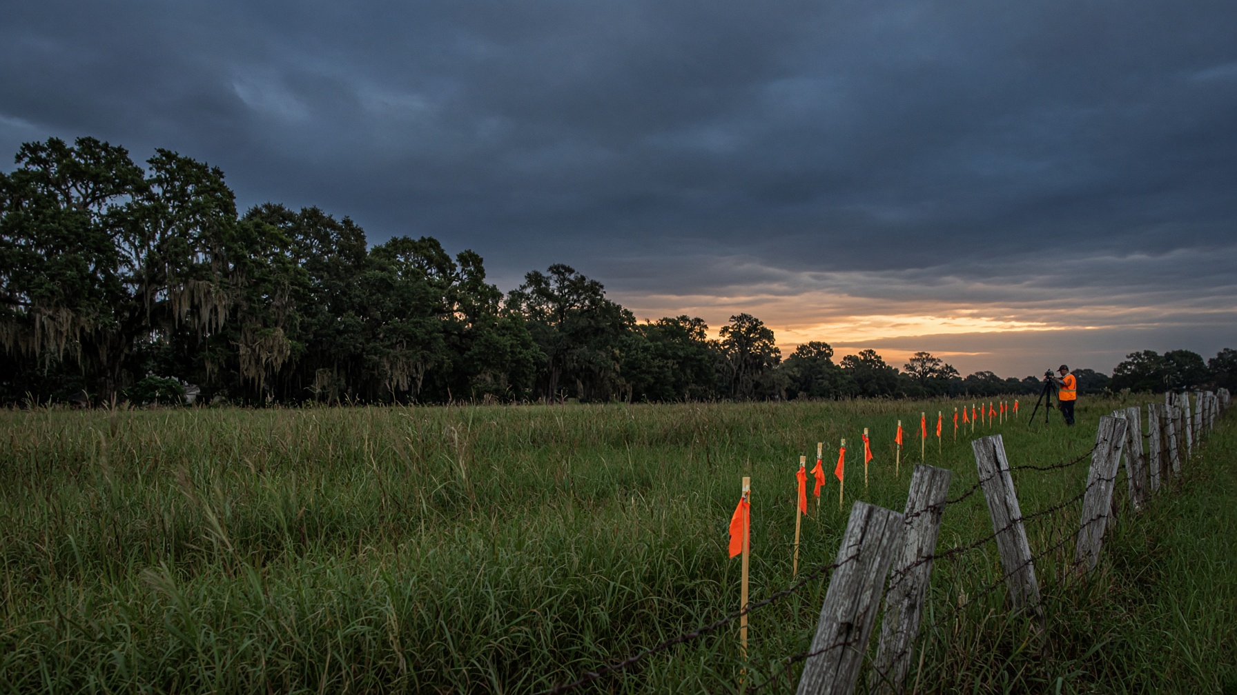

Land survey markers and fence line at sunset in Louisiana.
A Fence Beat Two Surveys in Louisiana
A Louisiana court fixed a boundary at an old fence instead of the surveyed line. Plus the NAD 83 wait, the drone rules, and a correction.
Acquisitive Prescription Wins in Louisiana
A Louisiana appeals court affirmed a judgment fixing a boundary at an old combination fence instead of the surveyed line, relying on acquisitive prescription and finding no manifest error below. The Colvins had ordered a 2022 survey; an earlier 2012 survey had itself referenced that same old fence. The record also features no-trespassing signs, floodlights, and a dead cow.
Why it matters: Your line can be correct and still not be the boundary, and the fence a predecessor noted in 2012 is part of the reason.
Colvin v. Jones, Louisiana Court of Appeal, via FindLaw →
